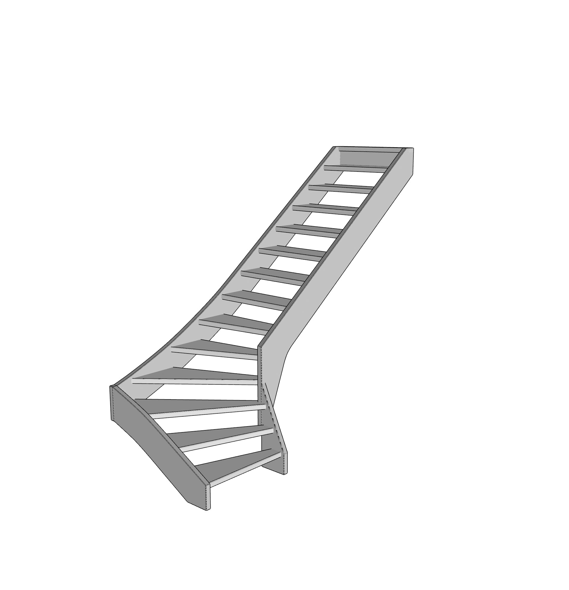

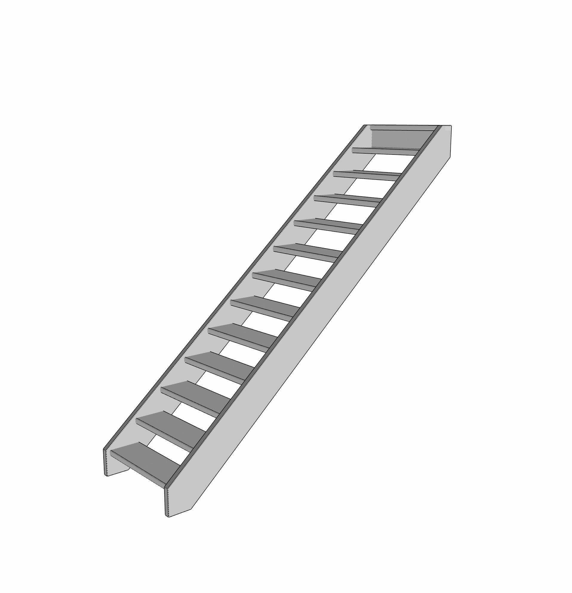

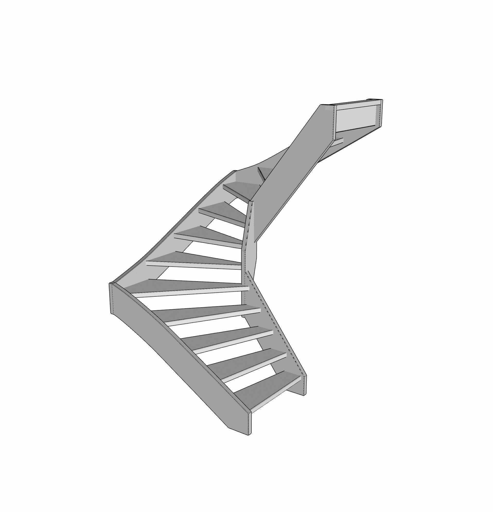

CAD files in the form of .dwg and .dfx are available for direct download in the most common shapes, straight, L- and U-shaped. If you need other file formats or shapes, please contact us.
L2-14-2900-H.dwg/dxfZIP12 KBLadda ner
R1-14-3350-H.dwg/dxfZIP12 KBLadda ner
U2-14-1900-H.dwg/dxfZIP14 KBLadda ner

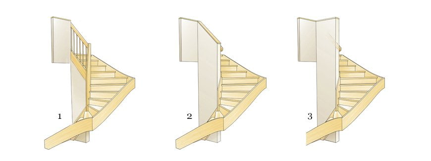

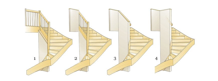

Spindle walls and cover
We often supply covers for spider walls either in top-painted mdf or in a type of wood that matches the stairs. Shown below are four common types of spider walls. If we are to supply cover caps for this type of wall, we need to know the thickness of the wall. We deliver the cover as standard in the dimension wall thickness+14 mm (7 mm overhang on both sides).
